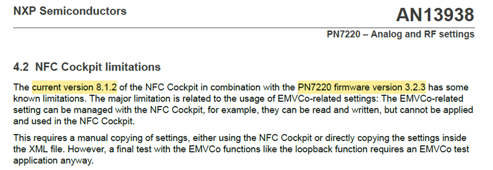

We have 2 questions need support as below
  1. Where can download Cockpit v8.1.2? (the version reference from AN13938 rev.2.0 as below screenshot)
    Could you please provide that download link for Cockpit v8.1.2?

Hello @chiajeng
1)Sorry, there should be a typo, the current version of 8.1.2 is not available, the latest version is 8.1.0
2)There should be have a document for this, but it's still in preparation stage. I can forward the draft for your reference, please check your email.
