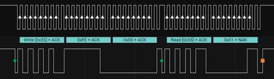

KaiLi
Hello @shank
Could you provide the  I2C sequence diagram? As shown in the following picture, let us see if the I2C communication works fine.
Or you can refer SW3647 to debug your code. SW3647 canbe downloaded from the below:
OM5569-NT322E | NTAG I2C plus Explorer Kit | NFC | NXP Semiconductors
