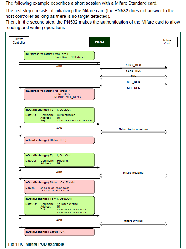

Hello friends,
I am using PN532 NFC Reader to read the NFC card number. I have already read the card number but now I want to read the data from different sectors present in the card, So Is there any command or way to read from a particular sector's data.
Hope you guys will reply as soon as possible.
Thanks in advance!!
Krishna K H

Please kindly refer to the following for details.
Hope that helps,
