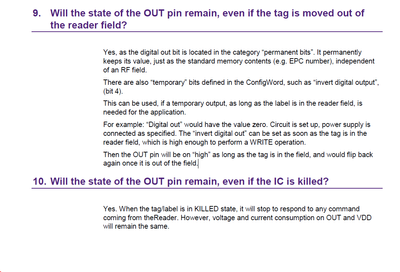

Hi all,
I have a question about the behavior of G2im+ IC in the following conditions:
1. If the TAG is very small and is too far away from the reader, in this case, it is possible that the IC receives enough energy to turn on, but the response of the tag is too weak for the reader to receive it.
2. Permanent bits digital output is pre-programmed to "ON" (Address 210h).
The question is: whether the G2im+ chip will give "1" to the digital output (OUT) even if there is no stable connection in the reverse direction (from the TAG to the reader)?
Thanks in advance,
Yuriy.
P.S. TAG is in fully passive mode without external powering.

Hello @YuriyPod
Thanks for contacting us and choosing the NXP products.
The below information could be helpful to you.
