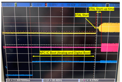

The XTAL start-up time for our products is typically in the range of 0.3 - 1 ms. This also strongly depends on the used XTAL + XTAL oscillator PCB layout.
Our products typically use a standard Pierce oscillator.
Newer products like PN5190, PN7642 and PN7220 contain an XTAL boost mechanism which increases the "gm" value during XTAL start. That helps to speed up the XTAL start. But still, the XTAL start is typically in the range of hundred microseconds.
Can you share more details about your measurement? Do you have some waveforms (e.g.  XTAL2 signal)
Btw. we have a new app. note dealing with the XTAL oscillators -> https://www.nxp.com/docs/en/application-note/AN14518.pdf
You can have a look.
Tomas
538 次查看
Y1qdefrsgfsgsr
@Tomas_Parizek
Thank you for your response. I will carefully review the document you provided. Regarding the signal testing process, I have included the details in the attachment for your reference. I hope this information will help us make progress together.
Additionally, I tested the current of the RC523 on my custom EVB board. In one of the test items, there was an anomaly: in the soft power-down state, the circuit current was 2.19μA; while with the crystal oscillator on and no field switching action from the chip, the current was 7.07mA. In comparison, another company's NFC chip showed current values of 0.94μA and 952.87μA under the same conditions. When only the crystal oscillator is turned on, the current for the RC523 is noticeably higher. I am wondering if this could be an issue with my test method? Also, when you perform your tests, what is the current value when only the crystal oscillator is on? I couldn’t find the corresponding parameter in the datasheet.
