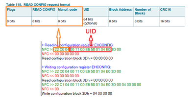

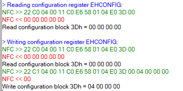

Hello @GoncaloS
Please refer the following log to format read and write command:
4,165件の閲覧回数
GoncaloS
Hi @KaiLi,
In my side, I tested the commands that you sent and worked.
What do I need to do now?
GoncaloS
タグ(3)
4,143件の閲覧回数
KaiLi
Hello @GoncaloS
UID should use your UID.
4,128件の閲覧回数
GoncaloS
Hi @KaiLi,
Thank you for your reply.

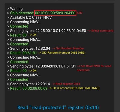

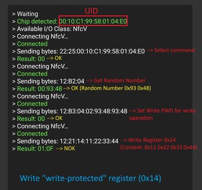

As you can see in the image in the previous reply, I entered the UID when I ran READ CONFIG and WRITE CONFIG. I also don't understand how these READ CONFIG and WRITE CONFIG commands help to solve my problem.
However, I still have the problem of not being able to write to a memory region protected with a plain password. Can you replicate the commands I sent in the first ticket to read a memory region that is protected?
Please see the photos attached:
- Read/Write Password
ReadWrite_PWDReadWrite_PWD
- Read "read-protected" register
- Write "write-protected" register
Write "write-protected" registerWrite "write-protected" register
