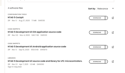

Hi, thank you for sharing the link to the product. I checked it and it seems that the NTAG5 link can control I2C devices. So it must be programmable. I was wondering if you have example codes that I can refer to?
Thank you!
3,607 次查看
Tomas_Parizek
Hello samiha1234
For this product, we offer an evaluation board:
https://www.nxp.com/products/rfid-nfc/nfc-hf/connected-nfc-tags/ntag-5-development-kits:OM2NTX5332
+ some FW examples
Please look at them
Tomas
