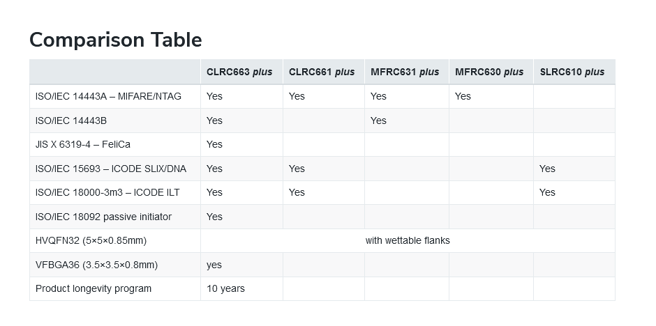

I am fine with any kind of tag. I just have two requirements: It must fit into a small toy figure and possible distance to the reader should be at least 5cm.
I found this page TOYS-BOARD-GAMES ,which recommends the PN512 for Smart Toys with NTAG. But also the MFRC630 seems to be a good choice. Maybe you can explain when it's better to go with the PN512 instead of the MFRC630 (and maybe why the CLRC663 plus is even better).
In terms of tags: The ICODE ILT seem to support a really good anti-collision. I don't know if this is needed for just 5-10 objects.
The last question is, which of these chips works well with Arduino / ESP32 and where can I find external antennas, which I can deal with a big surface (50x40cm).

The PN512 it's not recommended for new designs, while the MFRC630 is dedicated for MIFARE tag.
Before choosing a reader you must know which kind of tags you will be using as well in your devices,if you are using ICODEs maybe the SLRC630 plus  it's a better fit for your design or even the CLRC663 plus. Both of this are front ends, that means this are command based , if your IC can deal with all the requirements of the device to send the commands and respect the NFC timing s, you can use them, still you will need to migrate the library we provide.

Can you help me to choose the right tag? I would really like to understand the difference between MIFARE and ICODE. How do the tags differ in terms of:
- reading distance (10cm)
- anti collision support (up to 5)
- size
- support for a big external antenna (like 500x400 mm)
Maybe there is a good comparison matrix somewhere. The same would be nice to compare MFRC630 and the CLRC663.

estephania_mart
Which is the application you are using ?
There are several tags that can fit in the requested elements.
This table was gotten from this link
Hope this helps,
