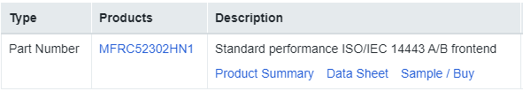

I just have a quick question regarding the Pegoda Reader. Is it capable of being configured to emulate an NFC tag?
Thank you

Hi Wilmer Suarez,
Hope you are doing great, as you may know the frontend used in the pegoda reader is the  MFRC523
this is just a ISO 14443 A/B reader, so Card emulation is not supported by this reader.
https://www.nxp.com/docs/en/data-sheet/MFRC523.pdf
Jonathan
