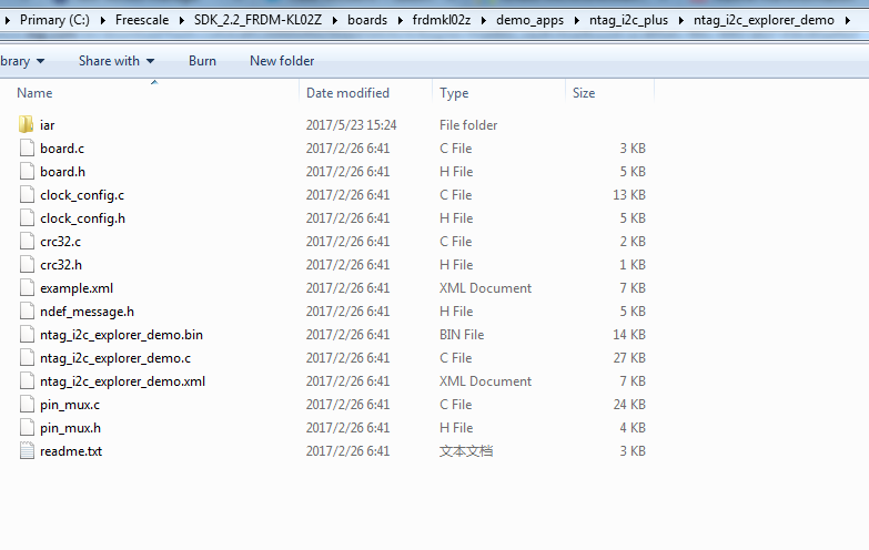

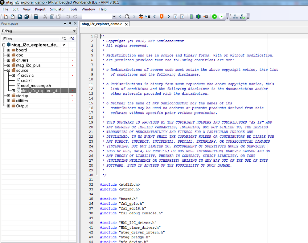

Kan_Li
Hi Gaurav,
Thanks for the information! Referring to your code, looks like you ported this LPC project to KSDK project, but actually we have already provided the ported project in the latest ver 2.2 sdk, please kindly refer to the following for details.
so I think maybe that is a better starting point for your application.
To download the latest sdk, please refer to Welcome to MCUXpresso | MCUXpresso Config Tools
Hope that helps,
Kan

Kan_Li
Hi Gaurav,
I didn't find any wrong with the files you sent before, but it is recommended using the official lib for your application , because there is a ready demo for your reference, and you may speed up your development with that. I have also consulted with ksdk team, sdk 2.2 also supports kl03, though its BSP doesn't include NTAG I2C demo, but it is easy to port it from kl02 to kl03. Actually there is no big difference between them, and they both support I2C communication.
