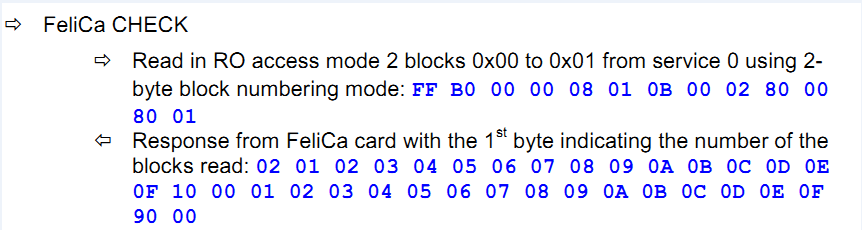

rakeshkhatal
Hi Kan,
Do you have command lines for PR533 to set it in customers application.
Customer is using c++ platform for developing an application.
SDK / API / Demo application code.

Kan_Li
Hi Rakesh Khatal,
I found the following info might be helpful for your case.
Hope that helps,

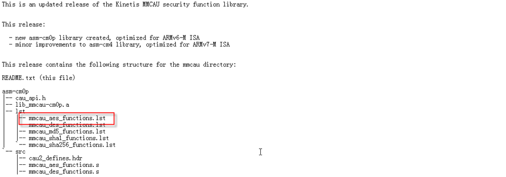

Kan_Li
Hi Rakesh Khatal,
Actually our NFC reader ICs all have no AES support, but our Kinetis MCU has a mmcau co-processor inside, which support AES, the lib can be found in KSDK 2.1, shown as below:
If you want to use MCU as Host, it could be a solution.
