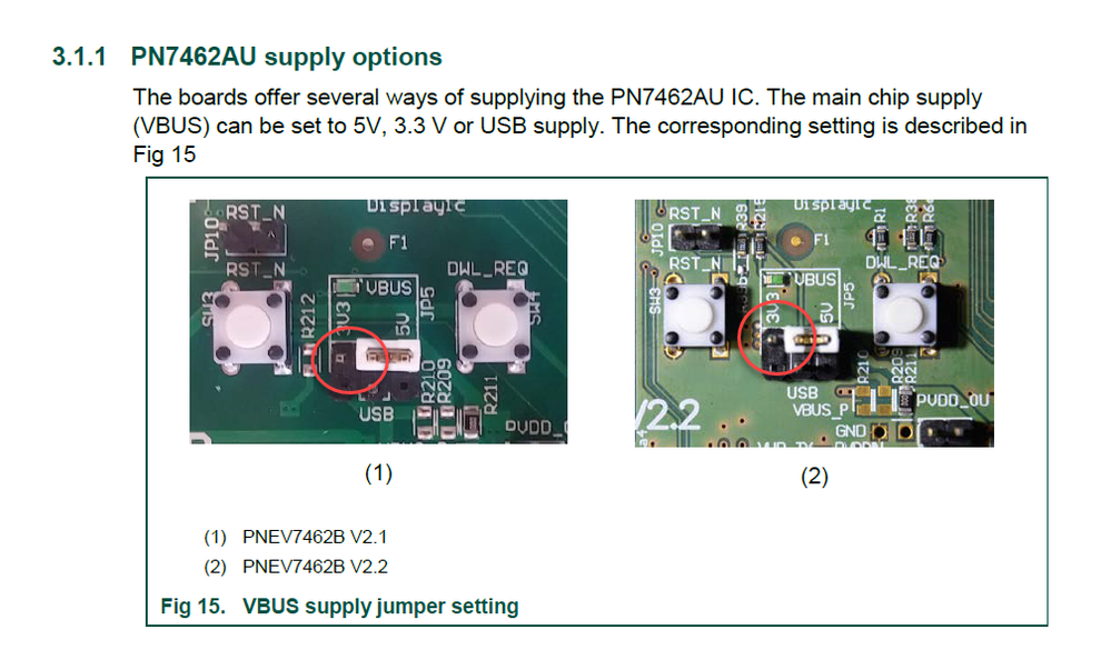

I am building my application on Door access application which works with 5V(VBUS )power supply in EVM board.
This application does not work for 3.3v in EVM board.
we have made changes according to UM10883 for 3.3 and 5v system.
Any particular changes to be made in software or hardware?
Sanath Rai
2,789 Views
Kan_Li
Hi Sanath Rai,

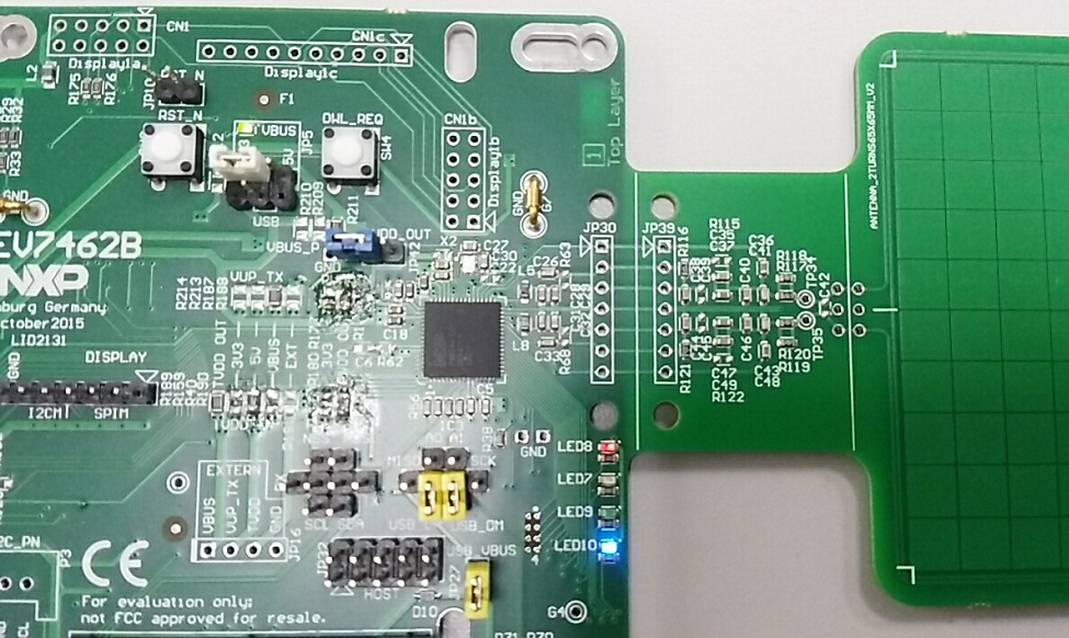

Did you change VBUS option as below?
If yes, I also tried and it works well as expected.
The board version is PNEV7462B.
