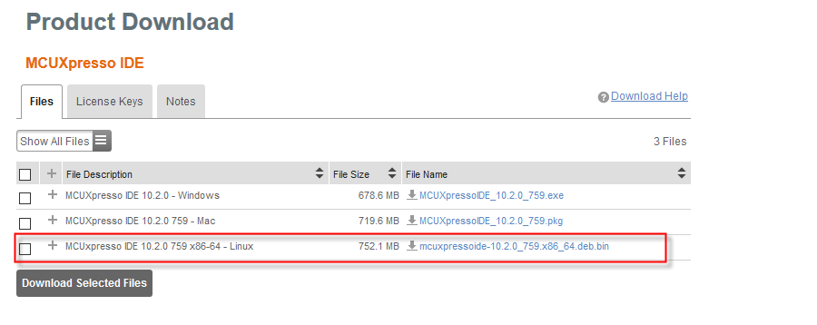

Hi Pra,
I am sorry, but are you referring to MCUXpresso IDE tool or the PN7462 plugin? Actually the PN7462 plugin is just a zip file can be imported by MCUXpresso IDE under any operating OS, for Linux version MCUXpresso, you may download it from our web site:
Kan
1,676 Views
lpcxpresso_supp
Please do not try to import the PN7462 plugin created originally for LPCXpresso IDE into MCUXpresso IDE. This plugin has been built into MCUXpresso IDE since v10.0.2.
