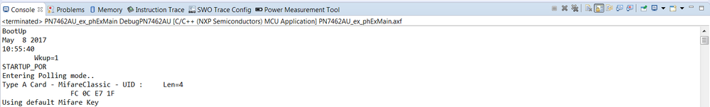

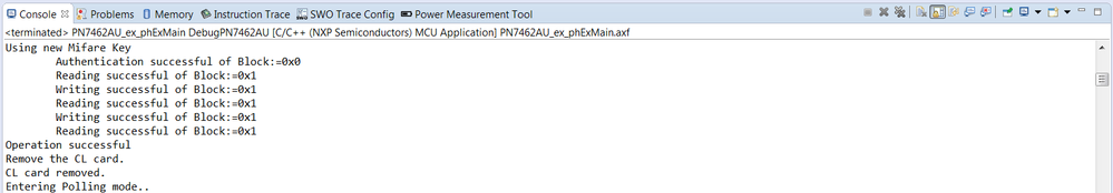

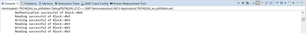

IvanRuiz
I just ran the project and it is working fine, the leds stop shifting when PNEV7462B detects a tag, once the tag is not within the field they shift again.
Make sure the power of PNEV7462B is stable and the project runs normally (it is not stucked in any function or interrupt).
