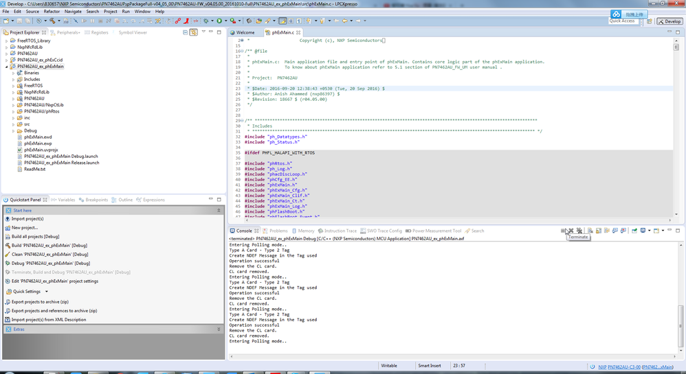

Dear Ladies and Gentlemen,
I use following system:
-LPCXpresso V8.2.2 [Build 650]
-Eclipse plugin: com.nxp.pn7xxxxx.update-8.0.0-SNAPSHOT-163.zip
-Development board OM27462CDK
I installed and followed the instruction in UM10883.pdf.
According to manual of UM10883 the example PN7462AU_ex_phExMain should run with RTOS. Compilation runs fine also debugging.
I randomly get the message "stalled on bus operation" in the status bar of LPCXpresso and the led's  on the board are not glowing and the board is not giving any response to the code(it is not reading any card).
Can anyone help me?
What am I doing wrong?
Thank you very much and best regards
haran sai

Hi Haran,
I have tried that demo with LPCXpresso v8.1.4, it works just as expected, Please kindly refer to the following for details.
Kan

Dear Sir,
I am using following system:
According to manual of UM10883 the example PN7462AU_ex_phExMain is running properly.
And I randomly get the message "stalled on bus operation" in the status bar of LPCXpresso.
what is meant meant by stalled on bus operation and why it is coming frequently and I am also facing another error
16: Target error from status-poll: Ee(FF). Redlink interface error 255.
Can u pls help me sir ?
haran sai
