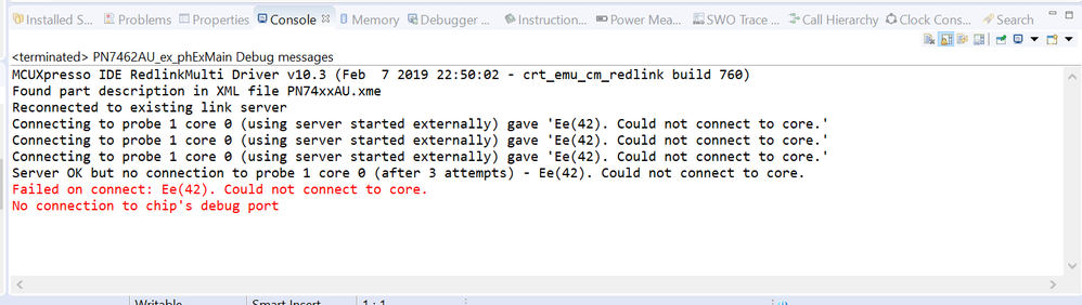

Dear All,
We are facing issue while Debugging PN7462 chip and we are using LPC LINK-2 to debug. MCUXpresso IDE shows following error message:
MCUXpresso IDE RedlinkMulti Driver v10.2 (May 10 2018 18:10:59 - crt_emu_cm_redlink build 510)
Reconnected to existing link server
Connecting to probe 1 core 0:0 (using server started externally) gave 'Ee(42). Could not connect to core.'
Server OK but no connection to probe 1 core 0:0 (after 3 attempts) - Ee(42). Could not connect to core.
Failed on connect: Ee(42). Could not connect to core.
No connection to chip's debug port

I have exactly the same problem on my board OM27462CDK when debugging an example code in MCUXpresso :

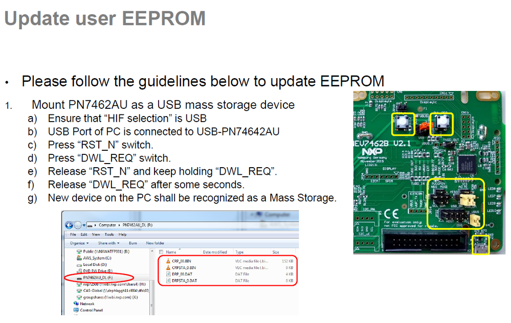

I don't succeed to resolve it. I tried to update the user EEPROM but it didn't change anything.
Do you have another solution to solve this problem ?

I succeed to solve my error. Instead of use a LPC_Link2 debugger, I used a
Segger J Link debugger and it compiles and debug my code normally without
error. I can reuse my board now.
Louis.

amolborase
Hello Louis,
I have faced the problem of  cannot halt processor and get solved by updating the CRP and DRP file with original one into USB Mass Storage Mode. You can try this to solve you problem, mostly it will be solved.
