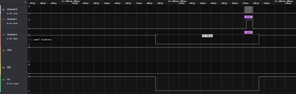

What could be the reason if PN7160B takes MISO down immidiately after CS is set low?
I have custom board with the chip and it worked and read cards.  Yesterday it started to behave like this.
I think it fails some internal checks, but how to debug it? Voltages on supply pins are correct and external crystal is oscillating at 27.12 MHz
