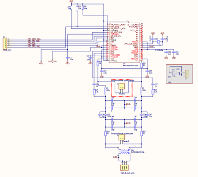

Hello.

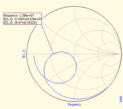

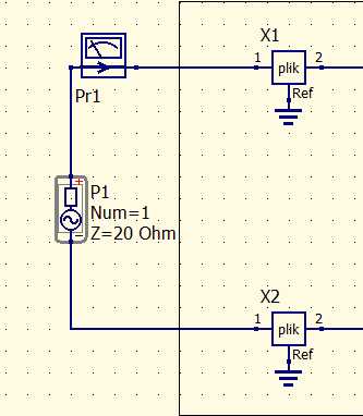

I have a small issue with matching the antenna to the PN7160 circuit. Everything seems fine, but not completely. The system operates in a single-ended configuration with the DXW21BN2511N# balun, in the setup as shown below.
X1 and X2 are inductors LQW18CNR16J00D (S1P models). X3 is the S1P measured using a VNA together with the balun. The simulation shows correct component selection:

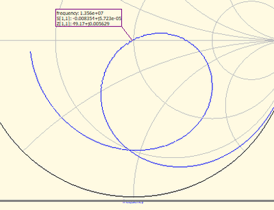

The measurement in the actual circuit is very similar:

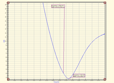

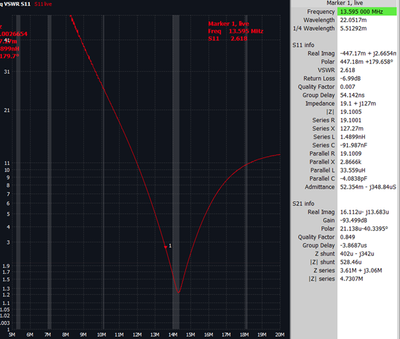

However, the SWR measurement indicates that the circuit is not well compensated.
The simulation shows the same as well:
The system works and reads NFC cards, but sometimes it freezes, generating a continuous 13.56 MHz signal, which leads to overheating. Where could the problem lie?
Krzysztof

Cześć Krzysztof,
I would say that the matching looks fine. You have almost exactly 20 Ohm.
The reason why you see this VSWR is that you are using 50 Ohm impedance system for your measurement while the impedance of the circuit is matched to 20 Ohm.

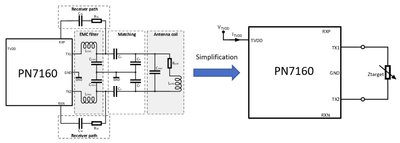

We don´t use the VSWR because the output impedance of the chip is not 50 Ohm.
We rather use this approach :
And then the output power of the chip respectively its input current can be calculated as described here ->
https://community.nxp.com/t5/NFC/PN7160-PN7161-DPC-Symmetric-Tuning-Values/m-p/1922063/thread-id/119...
About the overheating. Can you check the TXLDO input current (VDD(UP) pin) during the continuios 13.56 MHz ? This current shall not exceed 250 mA.

KLP
Yes, I confirm. After changing the generator's impedance from 50Ω to 20Ω, the SWR now shows correctly.

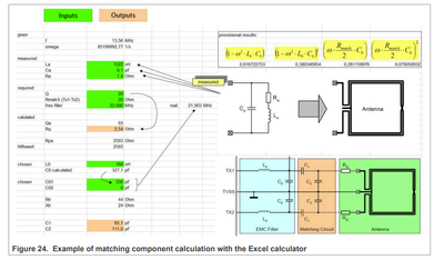

Are the calculations from the spreadsheet the same when using the antenna with a balun as in the version without the balun? I have significant discrepancies between the spreadsheet, the simulation, and the actual circuit.
6,615 次查看
Tomas_Parizek
Hello KLP,
Are you refering to this Antenna calculation excel sheet?
Or the TX driver current calculation I shared before ?
Tomas

YES. The measured current is 244[mA] and the calculated current is approximately 180[mA].

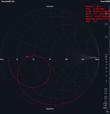

KLP
"What values of imaginary resistance are safe for the circuit?"**
5,375 次查看
Tomas_Parizek
Hello @KLP ,
Ideally, if the antenna is properly tuned. We recomenend to have imaginary offset +-3 Ohms from real axis for best efficiency. E.g. If your target tuning should be 20 Ohm. Then It is acceptable to have it as 20+-3i Ohm
If you detune the antenna by a card or a different object, the impedance will change to e.g. (7-40i) Ohm. Then the impedance seen by TX1 & TX2 is given by its absolute value.
|Z| = √(R² + X²) -> √(7² + (-40)²) -> |Z|=40.6 Ohms
So, it is always about combination of the real and imaginary part and their absolute value.
The absolute value should not drop bellow approx 15 Ohms which might lead to TX overcurrent.
Tomas

KLP
So this is a result I can consider quite decent?
5,214 次查看
Tomas_Parizek
Hello KLP,
Yes, this is perfect !!
