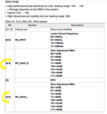

Try to reduce the gain to 39dB or 32dB and check the performance.

Please try the following:

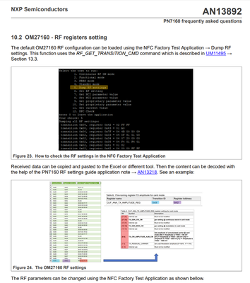

Could you "Dump" the RF settings from the functional and non-function boards and share them with us, please?
We think that the issue is caused by noise on Rx lines. This could be eliminated by adjustment of the CLIF_ANA_RX_REG register -> PN7160 RF settings guide -> 3.4.7
Tomas
27,052件の閲覧回数
Alb
Hi Thomas,
all the boards have the same dump (see attached file). We reduced gain to 39dB and it works at -5°C but detecting distance is very short. 44dB seems a good compromize. I have a question about rf setup. Before your suggestion we didn't set gain and the dump value is 0x66 (default?): is there a doc where I can find all registers default value? There a lot of registers that are not set in rf setup and we would like to be sure that they have a default and known value.

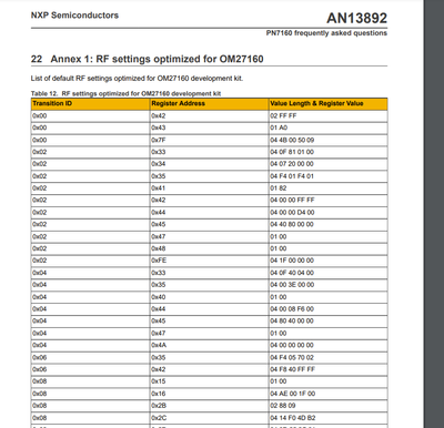

See the PN7160 frequently asked questions document -> Annex 1
Tomas
27,042件の閲覧回数
Alb
Hi Tomas,
I saw the optimized parameters table in the faq but I can't set hundreds of registers....
A lot of values are the same I have in my dump so I suppose that are defaults because I never set them in my configuration. I need to know which is the standard config of a device that comes out from nxp so I can set only the registers that are different with respect to default and are required by optimized configuration reported in table 12 of AN13892.

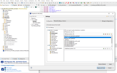

Also, one thing which could affect the Reader's behavior is the wrong setting of Dynamic power control. Can you disable it in the following way, please?
uint8_t NxpNci_CORE_CONF_EXTN[]={0x20, 0x02, 0x5F, 0x02,    /* CORE_SET_CONFIG_CMD */
    0xA0,0x40,0x01,0x00,                                  /* TAG_DETECTOR_CFG */
	0xA0,0x0B,0x57,0x10,0x10,0x90,0x72,0x0F,0x4E,
	0x00,0x3F,0x95,0xB7,0xAA,0x3F,0x9F,0xA7,0x99,0x52,0x9F,0x97,0x99,0x5B,0x9F,0x97,0x99,0x5D,0x9F,0x97,0x00,0x66,
	0x9F,0x07,0x00,0x68,0x9F,0x07,0x00,0x72,0x9F,0x07,0x00,0x75,0x9F,0x07,0x00,0x7D,0x9F,0x07,0x00,0x7F,0x9F,0x07,
	0x00,0x88,0x9F,0x04,0x00,0x8A,0x9F,0x04,0x00,0x93,0x9F,0x04,0x00,0x95,0x9F,0x04,0x00,0x9E,0x9F,0x02,0x00,0xA6,
	0x9F,0x00,0x00,0xAB,0x1F,0x00,0x00,0xB5,0x1F,0x00,0x00,0xBE,0x1F,0x00,0x00
Tomas
27,437件の閲覧回数
michael_d_1983
Hi Tomas,
I have now performed 2 things:
* Lowered the TXLDO to 3.9V on the "optimally matched" circuit, which now gives us good results at room temperature. The current was indeed a little too high, I have not yet measured the new current.
* Disabled the DPC according to your settings. I thought that the DPC is disabled by default, isn't that so?

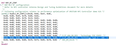

By mistake we put in the NxpNci_RF_CONF[] settings from the Evalboard, no idea how that is to undo and if it has influence.

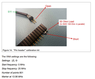

We have calibrated the VNA before each measurement.

  • Can you share a Smith chart before and after "cooling" by the spray? I would like to see if there is any change in the matching.

I have made the attached measurements in 2 configurations:
* The values calculated with the NXP tools which work well at least at room temperature
* The values matched using a VNA Smithchart, which do not give such good results
When cooling with cold spray, I could not observe any change in the smithchart, also the current at RF-ON seems unchanged.
Approaching an NFC card or a token changes the smithchart strongly.
