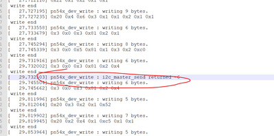

PN7150 communication Error pn54x_dev_write : i2c_master_send returned -6
2,021 Views
JamalChung

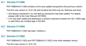

we found the "pn54x_dev_write : i2c_master_send returned -6" issue happened in PN71501, but PN71506 is good.
Is there any difference between PN71501 and PN71506 ?
2,014 Views
danielchen
Hi Jamal:
 Please refer to below picture for the differences between PN71501 orPN71506
