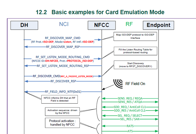

Dear, When the PN7150 functions as the card simulation function, a Huawei mobile phone fails to read the card simulation. Using Xiaomi/Samsung and other mobile phones to read card simulation successfully. Comparing the two log files, it is found that when Huawei mobile phone reads the PN7150 card simulation, it identifies NFC-DEP, while Xiaomi mobile phone identifies ISO-DEP. Whether Huawei mobile phones cannot read the sim card of the PN7150 due to some software configurations of the PN7150. Huawei mobile phones can read common labels and should support ISO 14443 Operating system: Android 13, For software Porting of PN7150, refer to AN11690-Android Porting Guidelines. The attachment "HuaWeiReader_pn1750cardemu0531.log" captures the PN7150 terminal as card simulation. Huawei phone reads the Android logs of the PN7150 terminal whose card simulation failed. The attachment "XiaoMiReader_pn1750cardemu0531.log" is the captured PN7150 terminal as card simulation. Xiaomi phone reads the Android log of PN7150 terminal successfully by PN7150 card simulated. What is the cause of this problem? Thank you! Best Regards!

Hi @jack_huang1
Please refer to below diagram for card emulation mode for PN7150, the default protocol used is ISO-DEP.
1,681 Views
danielchen
@jack_huang1
The problem is Huawei phone is using P2P as default.
You can try to disable P2P flag in libnfc-nci.conf,
set P2P_LISTEN_TECH_MASK=0x00.
and try it again.
