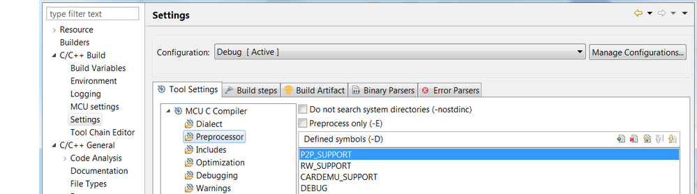

We are using PN7150 on a custom board based on im6ul EVK connected to i2c. We have compiled the NFC library (--enable-pn7150) and the demo.
Using the demo app, we are able to read from an NFC tag and also rewrite it. However we can't get a Nexus 5X running Android 7.1.1 to read information from the controller when emulating a tag or in p2p mode. The phone is able to read the same tag, but does not react to our antenna, nor do we detect the phone. We have not tried a different phone yet.
We have tried tweaking the /etc/libnfc-nxp.conf to use CFG1 because we use 3.3V and no battery, and we have also also turning off standby - with same results. Our design is based on the reference design and we didn't spot anything deviating from it.
Does anyone have any pointers at where we should focus our troubleshooting?

IvanRuiz
Please go to the project properties -> C/C++ Build -> Settings -> Preprocessor, there define the symbols you need (P2P_SUPPORT, RW_SUPPORT, CARDEMU_SUPPORT).
I hope this helps!
Ivan.

nikmarkovic
Hi Ivan,
Are you are maybe confusing the question with another project? I searched the whole NFC library, demo code and kernel source for all three strings/defines and none are coming up. Which source are you referring to?
I am doing the following:
  • Downloading the kernel driver from git://github.com/NXPNFCLinux/nxp-pn5xx.git and adding it to the kernel. (that part seems to work because communication works).
  • Downloading git://github.com/NXPNFCLinux/linux_libnfc-nci.git
  • Cross-compiling the code on Linux with
    ./configure --host=arm-linux-gnueabihf --prefix=/usr --sysconfdir=/etc --enable-pn7150
  • Installing the demo on imx6ul
  • Running the demo code with /usr/sbin/nfcDemoApp poll << this part works
  • Running the demo code with /usr/sbin/nfcDemoApp share -t URI -u http://www.nxp.com<< this doesn't work.
Thanks!
