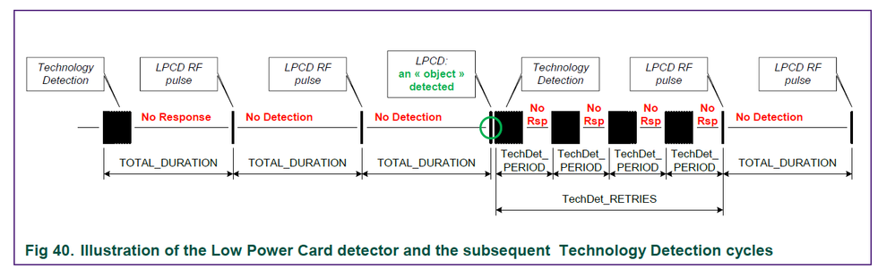

My current issue is that during the > 400 ms wait period, the NFC chip disables it's RF interface.
This in turn causes the controller/stack to disable the RF field and restart the polling process (looking for tags).
When the field is lost, the NFC chip shuts down and the process needs to be restarted.
Searching the PN7150 user manual i found the 'TO_RF_OFF_CFG' parameter which "Specifies the time out (inms) applied by PN7150before it restarts a Polling sequence, after it has detected a Field OFF in Listen Mode".
Would increasing the value of this parameter from the default 300ms help with my issue?
If so, is there any way to change this setting trough linux_libnfc-nci configuration file or function?

NCI defines the TOTAL_DURATION parameter for that purpose, please refer to the following for details.
To increase this time TOTAL_DURATION parameter must be extended. In NXP-NCI_example code this is done in this declaration:
/* NCI standard dedicated settings
* Refer to NFC Forum NCI standard for more details
uint8_t NxpNci_CORE_CONF[]={0x20, 0x02, 0x05, 0x01,         /* CORE_SET_CONFIG_CMD */
    0x00, 0x02, 0xF4, 0x01                                  /* TOTAL_DURATION */
Here TOTAL_DURATION is set to 0x01F4 = 500ms.

No. There is another way to set up this parameter.
TOTAL_DURATION can be set within libnfc-nci.conf file using “NFA_DM_DISC_DURATION_POLL” parameter.
For instance, defining “NFA_DM_DISC_DURATION_POLL=256” will configure TOTAL_DURATION to 256ms.
