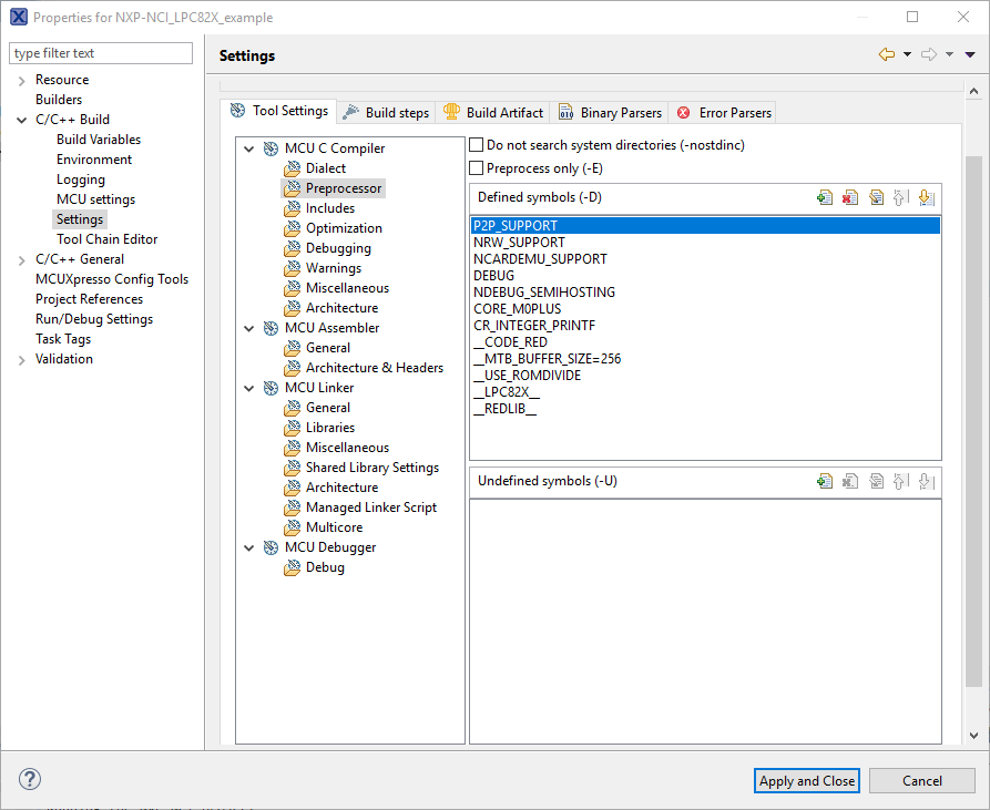

mario_castaneda
 Please look at  the Settings-Preprocessor
You could delete or uncomment the RW_SUPPORT and the CARDEMU_SUPPORT. Also, the P2P must be defined.
If you want to see the terminal commands, define the NDEBUG_SEMIHOST.
You should see the terminal information like this. The NDEF record sent
Mario
