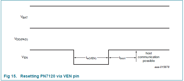

- As shown in the example project, before sending any commands to PN7120 it is recommended to reset it. This is done by pulling low the VEN pin as shown in a figure in the datasheet:
tw(VEN) is minimum 3 us while tboot is max 2.5 ms. The example project uses 10 ms for both.

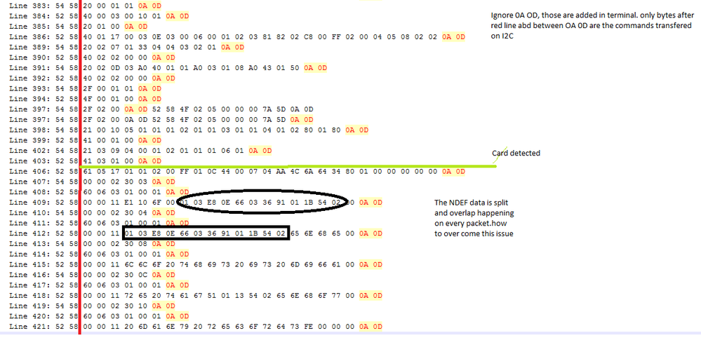

n_chandrasekhar
Hi Jorge,
Thanks for your reply. i am using NFC Sample Card supplied with NXP PN7120 evaluation kit. i have written 2 records using NXP android tool,
1. "hello this is mifare "
2."how many records " this were the records i have created on the card. i can see that in the line number 412 in abouve image "he" comes in the end,
in line number 415: "llo this is mifa"
in line number 418, & 421 contains remaining messages.
now problem is framing the data from the packets .. some times, as in circled,it is overlapping. as i understood NCI message supports 258bytes packets length, so how can i  get this as a single message till the length of 258bytes. also i can see the the packet fragmentation is not made as per seperate records also. it just dividing packets in lengths of 0x11.

Jorge_Gonzalez
Thank you for the details. So I guess your card is a MIFARE Ultralight EV1.
The NCI packet can indeed be 258 bytes long, but the fragmentation you see is a limitation of the Type 2 Tag READ command. Each command only returns 16 bytes. Subsequent READ commands must be sent if there is more data to read.
In your log above the NCI data packets starting with 00 00 02 30 XX are for reading the card's memory, where XX is the page number, each page containing 4 bytes. The packets with size 0x11 are the received data (16 data bytes + 1 status byte).
For this card in particular you could use the FAST_READ command to read more bytes at once. Just notice that this command is not available in all types of cards. Check the command details in the datasheet:
