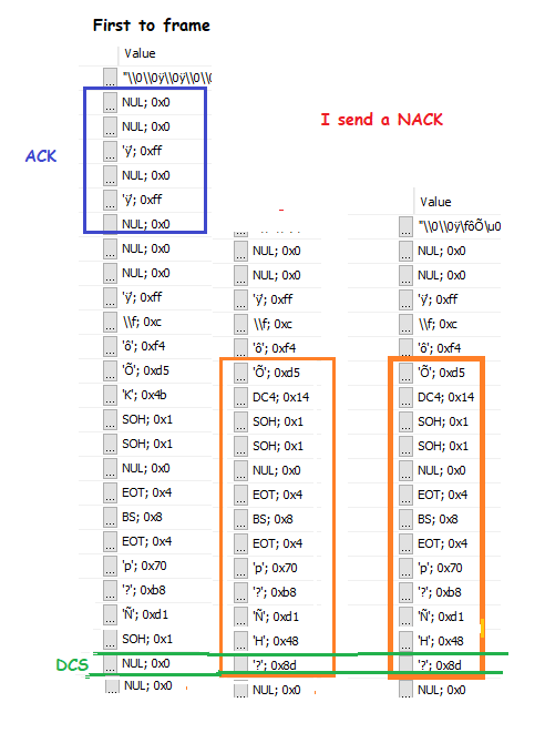

I have read in document 141520 (PN532 User Manual) that when the frame has an error of some kind, a NACK must be sent to the module so that it returns the next frame again.
But the problem is that the DCS byte is always wrong, and there is only the problem when I read the RFIF tag, for the other frames to configure the module there is no problem.
Here is an image of the frames received from the PN532:
The first column on the left in the first reception that contains the ACK frame plus the information frame.
The next two are those obtained after sending the NACK to the PN532.
The sum of the bytes that are enclosed in the orange rectangle must be equal to zero, otherwise the DCS byte is incorrect.
The sum is 0xC9.
And whenever I resend the NACK, it always returns the same frame.

Kan_Li
Hi @dominusdrr ,
Not only DCS byte but also TFI byte is wrong, and the check sum is always wrong in above cases, so I think most likely it is a hardware design issue, which module do you have? Where did you buy from?

Kan_Li
Hi @dominusdrr ,
Sorry for the confusion! I mean PD0 indeed, it is the command code but it should not be 0x14 in the response data.

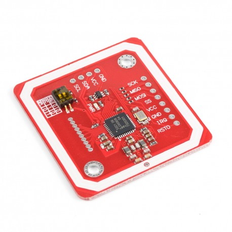

dominusdrr
Thanks a lot for answering, it is the module of this image:
They sell it in any electronic store.

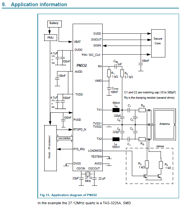

dominusdrr
Hi supposedly the module can work with voltages of 3.3V and 5V.
I'm applying 3.3V to the Vcc terminal.
Checking the schematic of the module and the datasheet, the main power pin is VBAT which supposedly can work from 2.7V, in theory there would be no problem, but for other pins that need 3.3V, the internal regulator of the chip is being used.
If I used 3.3V in VBAT, it implies that the internal regulator would not work properly and would be delivering voltages less than 3.3V.
Could that be the problem?
6,518 Views
Kan_Li
Hi @dominusdrr ,
The host interface's ref voltage is PVDD, not VBAT, which is the input of the internal LDO. so you have to check if the voltage on PVDD pin meets the spec of the host controller, in other words, better use the same power supply for PVDD and the host controller. Please kindly refer to the following for more details.
