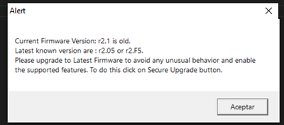

Eventually, I have connected my board to the kit so I can use NfcCockpit and figure out the root cause.
It comes up my board inlcudes an outdated FW for  PN5150 (FW 2.1):

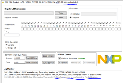

After upgrading to 2.F5 there is an alert I do not quite understand:
When setting RF on just a very light  burst comes out from the antenna.
14443A protocol loaded and there is an error when doing single-REQ:
I guess there are some missed or corrupted RF values set in EEPROM.
Is there anyway to come back to EEPROM defaults?
Regards, Ramon.

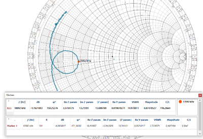

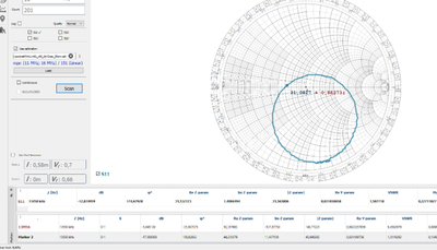

AS far as I know my tuing is close to the expected values (17 Ohm): 18-3j
But no RF is properly generated. When using LPCD the VDDPA seems too low, but still the reader detects the card on field, but no way the UID is read.

jr_hernandez
In the very begining I had a big capacitor missing in the EMI filter and had this impedance (31 ohm @ 13,56 MHz):
Curiously, the redaer was able to read UID and memory of ISO15693 card @ 60mm.
Is it possible that impedance is too low whie my new tuning, and current too high so VDDPA is turned off somehow?
Regards, Ramon.

renkebienert
Hi Ramon,
yes, that might be, but
17 Ohm normally is high enough to not exceed the default target current, so DPC shall not reduce VDDPA
even if the VDDPA is reduced by the DPC, the lowest values shall be 1.5V.
So I guess, either the chip is damaged or the RFon does not work due to a missing load protocol?
