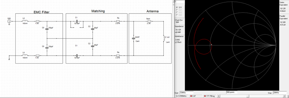

To maximize reading distance we opted for the PN5190 as it features the highest output power of all NFC frontends. Accordingly, the antenna (L = 2.1 uH) was matched acc. AN12549 with the low impedance of 16.6 Ohm (14.8 Ohm - j 7.5Ohm). Thus, the PN5190 should easily be able to drive a target current of 300mA.

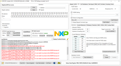

As a first step I tried to calibrate the DPC to set the target current at 300 mA and enable appropriate power reduction following NXP guides (while DPC is off, EEPROM cleared).
However, the unloaded Class-6 antenna (as well as other custom antennas) exhibits a ITVVD of only 160mA (as read from the NFC Cockpit), which is much lower than expected.
DPC can be adjusted below the 160mA, but it cannot be increased.

See attached antenna matching VNA results (measured from PN5190 160nH inductor EMV Filter) for appropriate antenna tuning reference.

Antenna: Class-6 acc. AN11276, measured to be L = 2.1 uH, R=2.3 Ohm
Chosen values as adapted by VNA and yes, following PN5190 antenna design guide, Chapter 4.4:
L0 = 160 nH, C0 = 560pF, C1 = 39pF, C2 = 97pF, Rs = 3.07 Ohm
The PCB layout definitely has an effect with its parasitic impedances, as the adjusted values (especially for C0) deviate quite a lot from the calculated initial values using AN12549 ( PN5190 antenna design guide, Chapter 4.2), which were:
L0 = 160 nH, C0 = 780 pF, C1 = 52.6 pF, C2 = 80pF, Rs = 3.07 Ohm.
Since the smith diagram looks right, I'm assuming the antenna tuning is fine.

My issue is not with DPC calibration itself, this is a future step. I'm confused as to why the ITVDD is reported to be much lower than the set target current while DPC is disabled and VDDPA is set to the 5.7V. See NFC Cockpit screenshot.

The difference in the selected components is significant. I tried to simulate your antenna, and these were my results:
  • L0 = 160 nH, C0 = 780 pF, C1 = 52.6 pF, C2 = 80pF, Rs = 3.07 Ohm
  • L0 = 160 nH, C0 = 560pF, C1 = 39pF, C2 = 97pF, Rs = 3.07 Ohm

Yes, the difference in selected components is significant, but the target impedance is met and smith chart looks appropriate. So I don't see an issue here.
What I describe is the behavior when the reader antenna is UNLOADED. When approaching a Class-6 antenna (from NTAG evaluation board) as a TAG, the loading indeed causes the ITVDD current to increase. But my issue is that ITVDD is 160mA when I select a target current of 300mA in UNLOADED situation.
Thank you. I could confirm that the NFC Cockpit ITVDD current correlates to the actual current measured in hardware.
DPC Calibration: Because I select a target current that is not reached (unless significant loading detunes the antenna at low distances), I cannot conclude the DPC calibration. See the following error:
Still, my issue remains that the actual ITVDD does not reach the selected target current, although antenna is properly tuned to 16 Ohm impedance.
