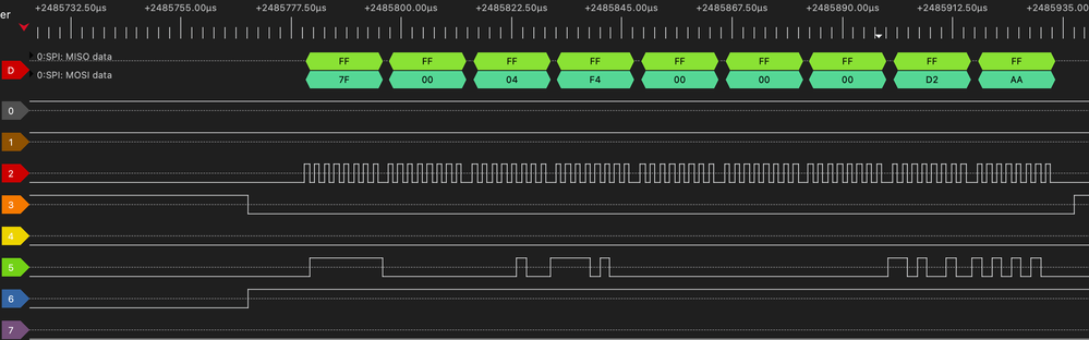

jonathanr
The sending of a GetDieId command:
The response:
Looks like the device do answer back in multiple packets and the current BAL exchange somehow only surface the second one somehow.
So yeah any pointer as to if the DAL from SecureDownload is different or not would help.
Also any pointer on actually support USER_SPI overall in SecureDownload properly also.
