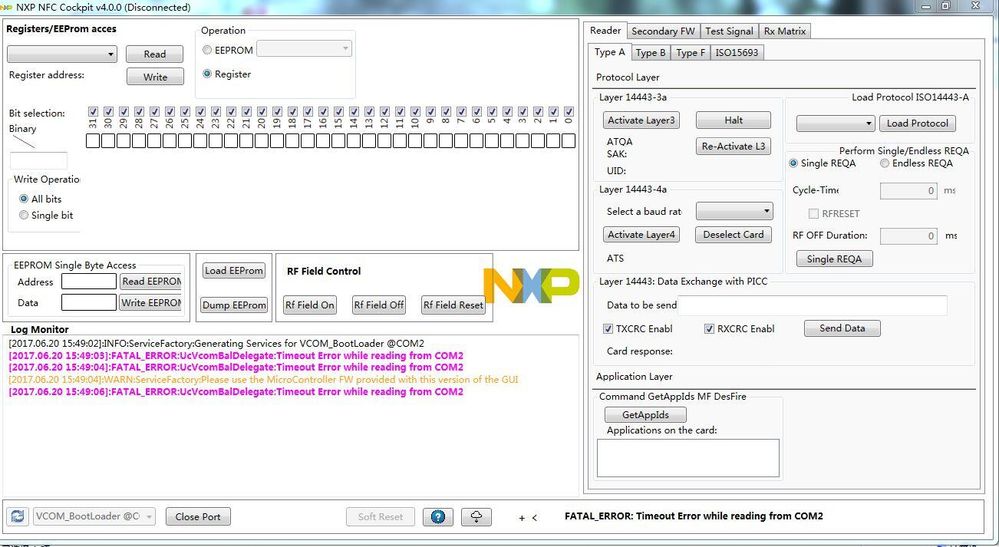

PN5180 demo board cannot be identify by PC computer,why?

Hello Qinghua,
   It seemed that you didn't install board driver for windows, see page 15 of AN11744.pdf(PN5180 Evaluation board quick start guide). So there was something wrong with communications.
