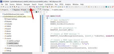

I upgraded the Debugger's firmware as descriped. This worked without any problems and the device is recognized by my OS as expected.
I then went on trying to flash one of the SDK examples (ndeft2t_hello).
Its build process went fine except for an popup telling me that GCC "does not allow the inclusion of non-freestanding library headers" when using the -ffreestanding parameter. It still was able to compile.
Unfortunataly, flashing the device still didn't work. Output:

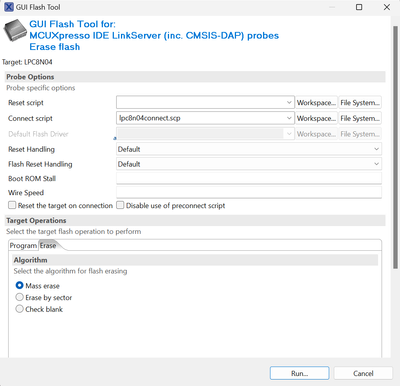

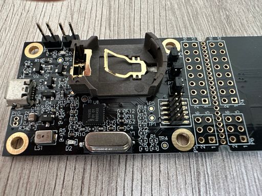

I would like to ask if you could please share a picture of the setup of your board in which the jumpers of all the board can be appreciated.

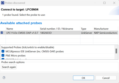

Could you please confirm that the debug probe is being detected by MCUXpresso as follows?
If the probe is being detected, could please try performing a Mass erase of the chip using the GUI Flash Tool of the IDE?
In this window select Mass erase and click on Run.
Please let me know your findings.
My best regards,

Here is an image of the jumper configurations.
OM40002 HW ConfigOM40002 HW Config
MCUXpresso does recognize the onboard debug probe.
Discovered ProbesDiscovered Probes
Unfortunately, the flash erase failed with the following console output:
Executing flash operation 'Erase' (Erase flash) - Fri Jul 04 09:15:21 CEST 2025
Checking MCU info...
Scanning for targets...
Executing flash action...
LinkServer RedlinkMulti Driver v24.12 (Dec 18 2024 18:34:07 - crt_emu_cm_redlink.exe build 869)

Content of CoreSight Debug ROM(s):
RBASE E00FF000: CID B105100D PID 04000BB4C0 ROM (type 0x1)
ROM 1 E000E000: CID B105E00D PID 04000BB008 Gen SCS (type 0x0)
ROM 1 E0001000: CID B105E00D PID 04000BB00A Gen DWT (type 0x0)
ROM 1 E0002000: CID B105E00D PID 04000BB00B Gen FPB (type 0x0)
NXP: LPC8N04
DAP stride is 1024 bytes (256 words)
Inspected v.2 On-chip Flash Memory LPC8N0x_30K.cfx
Image 'LPC8N0x (30K) Dec 18 2024 17:28:00'
( 65) Chip Setup Complete
Connected: was_reset=true. was_stopped=true
( 70) License Check Complete
Opening flash driver LPC8N0x_30K.cfx
Sending SYSRESETREQ to run flash driver
request to clear DAP error failed - status 5
After error Nn(05). Wire ACK Fault in DAP access -
Failed to read address register in DAP - Nn(05). Wire ACK Fault in DAP access
Failed to erase flash: Em(17). Debug port inaccessible after access at location 0x10000000
(100) Target Operation Failed
error closing down debug session - Nn(05). Wire ACK Fault in DAP access
Unable to perform operation!
Command failed with exit code 1

epi_lg
Hi @Daniel_Gutierrez,
Thank you very much for your efforts. Unfortunately, I'm still not able to bring that chip back to life.
I tried to use PIO0_0 before and during the LinkServer connection without any luck.
I also tried the same with Reset. That, sometimes if I press the button in a perfect moment during LinkServer connection seems to work at first.
Without doing this the LinkServer process reports the problem 'Ee(42). Could not connect to core.':
( 5) Remote configuration complete
Reconnected to existing LinkServer process.
Connecting to probe 1 core 0 (using server started externally) reports:
Retrying...
Server OK but no connection to probe 1 core 0 (after 3 attempts) - Ee(42). Could not connect to core.
 By spamming the Reset button and a little bit of luck the first error disapears:
============= SCRIPT: lpc8n04connect.scp =============
DpID = 0BC11477
Reset pin state: 01
DpID = 0BC11477
APID = 0x04770031
============= END SCRIPT =============================
Probe Firmware: LPC11U3x CMSIS-DAP v1.0.7 (NXP Semiconductors)
Serial Number: 01014009
VID:PID: 1FC9:0132
USB Path: \\?\hid#vid_1fc9&pid_0132&mi_00#9&819ceb&0&0000#{4d1e55b2-f16f-11cf-88cb-001111000030}
 Nevertheless, the actual command (flash erase in this case) then fails.
