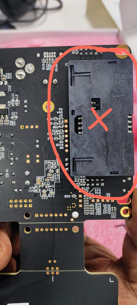

I have received OM27462CDK development board for PN7426 NFC application development. Can you help me to understand the highlighed portion in the back side of the development board. And please let me know the `best application example to start with detecting NFC card using the development board.

The highlighted portion in the back side of the development board is a contact slot interface (SMART CARD 5145300-2) that allows to enable communication with ISO7816 and EMVCo contact smart cards.
In order to start exploring this and other features of the PN7462, I would recommend checking out the “phExMain” example which is the root of many sub examples included in the "PN7462AU FW and SW Examples" package. This example allows to demonstrate contactless operation supporting TypeA, TypeB, Felica, ISO15693, ISO18000p3m3 protocols, as well as contact operation supporting ISO7816.
For further details on the different features available of the example and its setup procedure, please refer to section 9.2 of the PN7462 family Quick Start Guide.
