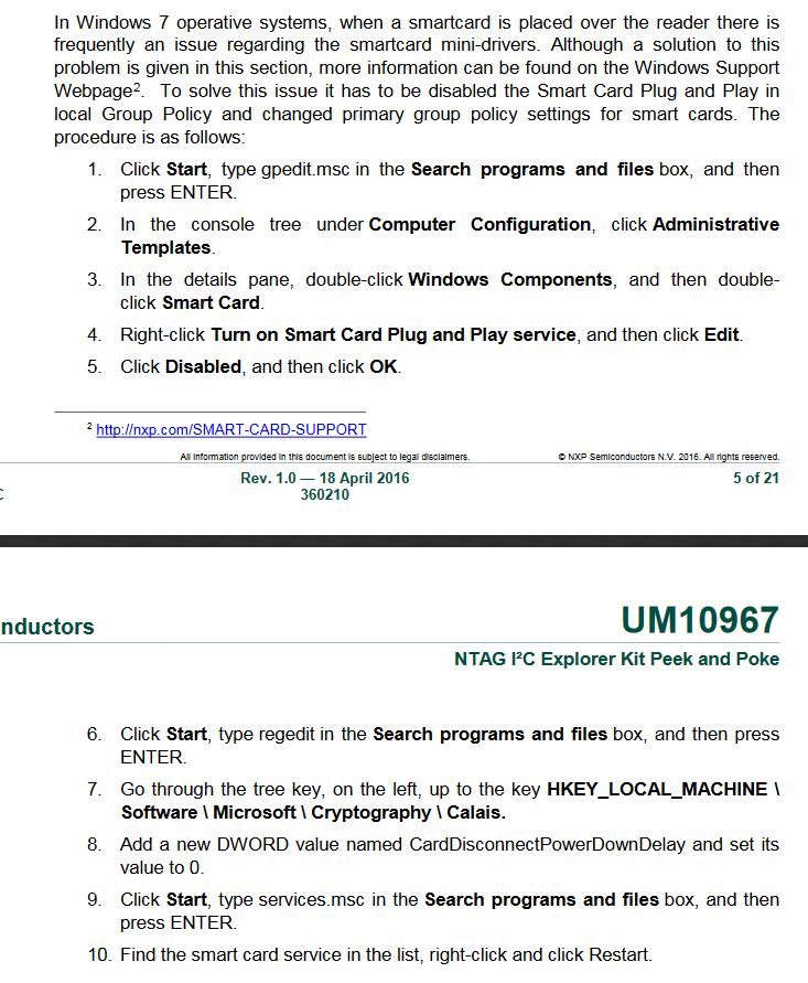

Kan_Li
Have you applied the solution as below?
Please kindly refer to http://www.nxp.com/documents/user_manual/UM10967.pdf  for more details.
Wish it helps.
Kan Li
6,622 Views
jlvern
The problem with gpedit.msc is that it is not available in many versions of Windows7  (Home Premium, Home Basic and Starter) ...
In my case, the NFC iDentiv uTrust 3700F reader did not work with "NTAG I2C Demo" until I update the firmware http://cache.nxp.com/documents/software/SW4044.zip (firmware dated 10/18/2016 !)... and now it works, but with bugs he seems. (Eg it only reads 992 bytes while the Android program reads 1928 bytes !).
