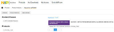

frederic_surleau
I downloaded SW7339 PN7462 MIFARE DESFire and MIFARE SAM AV3 v07.02.00 NDA v01.00.
I found "phhalHw_SamAV2_Cmd_SAM_ChangeKeyEntry()" in NxpNfcRdLib\comps\phhalHw\src\SamAV2\phhalHw_SamAV2_Cmd.c
It is exactly the same code as the one in NxpRdLib (sw171756), so I don't see the point...
As I said in my first post, it is not a BIG problem. I was just suggesting to do a little modification.
Fred.
