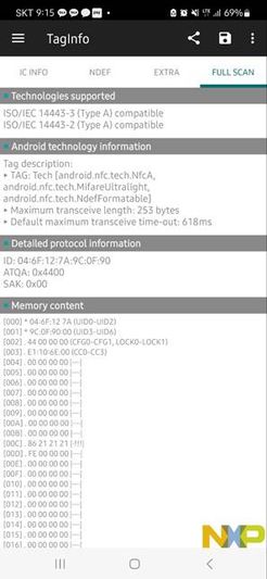

Hello, this is Jae-won.
NFC data writing is done through PASS-THROUGH SRAM.
NFC PASS-THROUGH SRAM WRITING problem occurred in the field.
Although AUTH authentication can be achieved with a smartphone, an abnormal symptom has been found that some products do not access the SRAM area.
I found the difference between not working and working, but I don't understand.
Even if it is not normal ndef data, if there is 0XFE in the NDEF area, it operates normally.
I am attaching some screenshots and code.
I've looked through the datasheet from scratch regarding the PASS-THROUGH SRAM operation, but couldn't find anything about it.
Please check quickly.
SRAM(0XF3) access and/WRITING normal operation memory
Pass-through sram memory (0XF3~) not accessible (products that are currently mass-produced and installed on site)
Config / Session reg area
When SRAM is not accessed ( 0xEC ED ) Memory contents read from the smartphone
(pass-through sram memory didnot be activated)
Only the values ​​below are kept
29 00 F8 48
08 01 01 00
Memory contents read from smartphone when SRAM is accessed ( 0xEC ED )
After maintaining the value below, sram is accessed normally.
69 00 F8 48
08 01 21 00

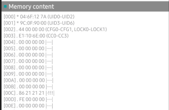

When the memory of the picture below picture 2
All of the actions below are possible.
1. Session reg read available
2. Protected user memory can read/write
3. UnProtected user memory can read/write
Only PASS-THROUGH is not activated and the SRAM memory area cannot be accessed.
It was confirmed that PATH-THROUGH is not activated when checking ns reg through I2C as well as NFC MOBILE operation.
All conditions (product, environment) under the same circumstances
my code is good working.
i set PASS-THROUGH, but it did not set PASS-THROUGH on  picture 2.
 picture  1 is that I have verified that it works correctly.

picture 1. PATH-THROUGH operation 100%
Please see 00Ch, 00Dh memory.
69 00 F8 48
08 01 21 00

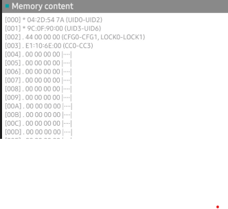

picture 2. PATH-THROUGH does not work 100%
When i added like 1 picture (just 2 line) ,  this is working 100%,
and i back to below . it do not work 100%
When SRAM cannot be accessed ( 0xEC ED ) Memory content read from the smartphone pass-through sram memory cannot be activated
Only the values below are kept
29 00 F8 48
08 01 01 00
PATH-THROUGH is activated according to the data written in eeprom. All other parts (settings) are the same
I can make this  Malfunction Problem always.

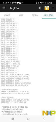

00C and 00D (0xC, 0xD) are User Memory, we need to see the configuration registers, please share with us the content of address: 0x3A for Config Registers. 0xF8 to 0xFB for SRAM and, the session registers 0xFE.
In case you have Passthrough Mode ON, address 0x3A byte 0 should show that Bit 6 is 1, along with this bit, the other configuration Fields should be set as your application needs. For further information, please check Table 13. Configuration Bytes of the NTAG I2C Datasheet

normally , SRAM access is ok.   Passthrough Mode control is no problem. it is work 100%
But,
I just erased USER NDEF EEPROM by 00.  SRAM IS NOT WORKING 100%.
I uploaded   Memory map screenshot from NFC perspective on first post.
that show 0xE8, 0xE9  memory .
That is same with 0x3A on I2C interface .
I set "Passthrough Mode ON " on session register .  i uploaded that code, already on previous post.

PATH-THROUGH operation 100% on normal case
