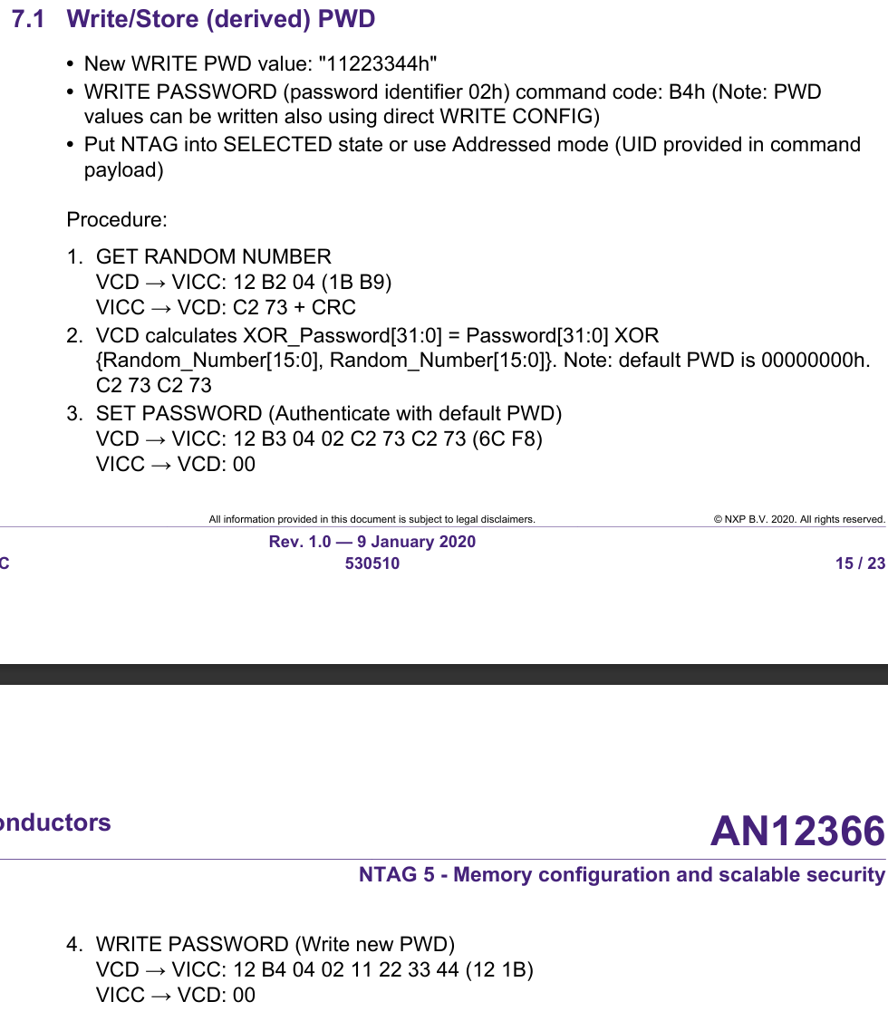

I followed the example described in chapter 7.1 Write/Store (derived) PWD using the following sequence:
1. Select Cmd (0x25)
0x22 | 0x25 | UID
Result: 0x00
2. Get Random Number (0xB2)
0x12 0xB2 0x04
Result: 0x00 0x89 0x45
3. Set Password (0xB3)
0x12 0xB3 0x04 0x02 0x89 0x45 0x89 0x45 (Write Password: 0x00 0x00 0x00 0x00)
Result: 0x00
4. Write new PWD
0x12 0x21 0x14 0x11 0x22 0x33 0x44
Result: 0x00
5: Write in write protected block
0x12 0x21 0x14 0x01 0x02 0x03 0x04
Result: 0x01 0x0F

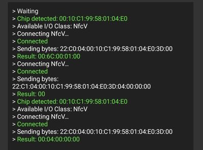

Please refer the following log to format read and write command:
2,305件の閲覧回数
GoncaloS
Hi @KaiLi,
In my side, I tested the commands that you sent and worked.
What do I need to do now?
