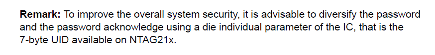

Hello Community,
how easy would it be to copy the UID of a Tag and the NXP Signature of that UID and recreate the TAG?
I know that the higher NTAG products have more security like password or AES but still once this kind of security is by passed wouldn't it be easy to steal the Identity?

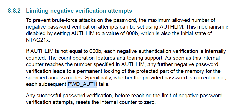

Hi Julian,
It is not so easy to bypass this kind of security , the data sheet of NTAG213 provides the method to improve the whole security, please kindly refer to the following for details.
Please kindly refer to https://www.nxp.com/docs/en/data-sheet/NTAG213_215_216.pdf?pspll=1  for more details.
