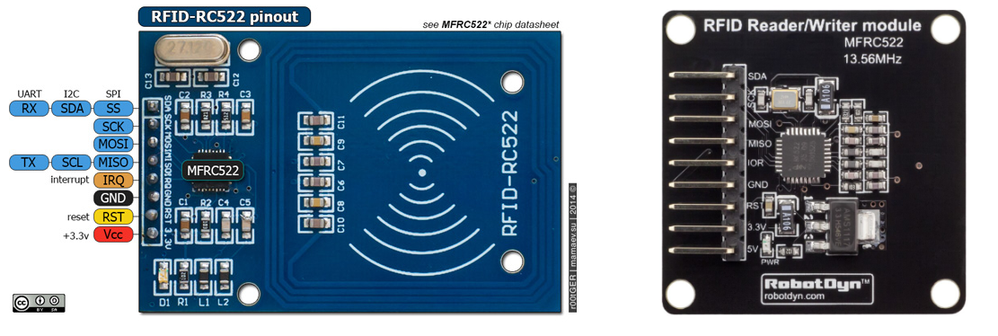

Components being used in the project:
  • Using Raspberry Pi (is preferred because this is an extension of an existing project and the Pi is available, the rest of the program runs on it + Gpio pins are available, as to not having to introduce another hardware part like an arduino).
    Using the mfrc522 library
  • Using the RFID reader/writer module (works with NFC) from RobotDyn (convenient 5V extra pin and smaller size) (see image below this)

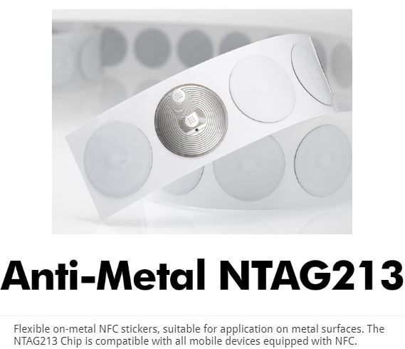

  • Using "On-metal Round NFC Tags NTAG213 22mm" (see image)

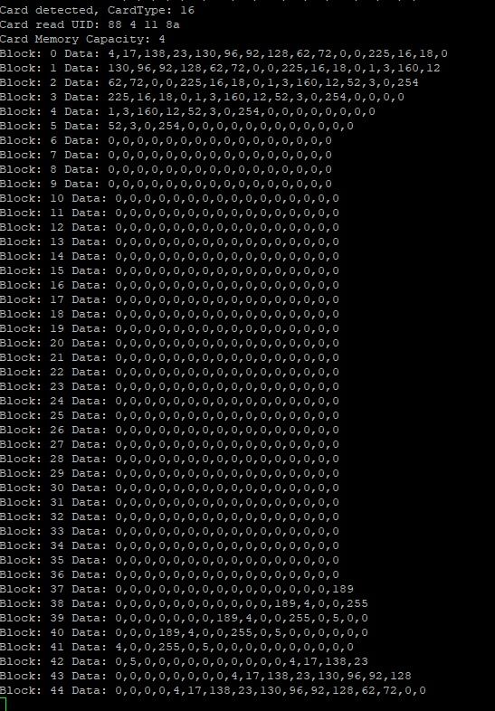

Here is a dump of the NTAG213 (read by the RobotDyn MFRC522):
I've read in the documentation that the authentication is being checked on black 7? Is that right?
I just have no idea how to change this key it uses.

Sabina_Bruce
Hello Ice,
I'd recommend to follow the flow chart that is on page 8 of the User Manual for the NTAG 213. In the following pages the commands that should be used to appropriately enter the authenticated state are described.  Section 8.8 explains how to proceed in configuring the password itself and the commands to be used.
The commands themselves are also described in the same document. Unfortunately we do not have any example code made with python.  You can check the NFC Reader library that has examples created in C, it does use different modules but you may get a general idea of what needs to occur in order to properly read and write the Tag.
As an observation in your code, it does need more information so your tag properly receives the instructions in needs to access certain areas of the memory. As you mentioned yourself you need to include the part that authorizes the user. This you will find described in the flow chart I've mentioned above.
