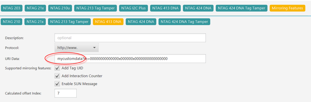

Is it possible to CMAC other data (eg. plain text) than tag UUID, counter?
6,204件の閲覧回数
Kan_Li
It is possible to CMAC your custom data, you may verify with the TagXplorer as below:
Kan
6,204件の閲覧回数

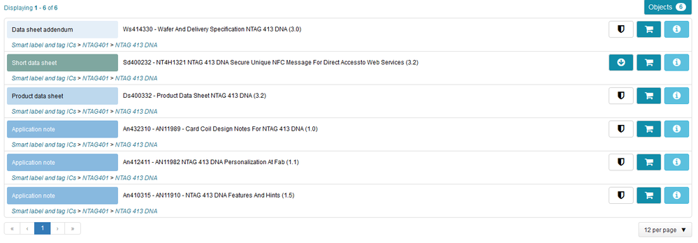

If I understand correctly, we are able to write our custom data (e.g. timestamp) to the NDEF, and then when tapping the tag with our device (mobile phone), our custom data is CMACed and read from the tag, right?
And if so, where can I read about how to set up the tag so when tapping, it CMACs our custom data written to NDEF. Here I mean technical details.
6,201件の閲覧回数
Kan_Li
You may request the following docs from the doc store:
Please kindly refer to the attachment for more details.

alkhasov_i
What I mean is encrypting any NDEF content (e.g PLAIN TEXT).
I do not actually understand what exactly is "mycustomdata" on the image.
6,201件の閲覧回数
Kan_Li
Thanks for the clarification! I am sorry NTAG 413 DNA doesn't support this, you have to use NTAG 424 DNA instead. Please refer to the following for details.
