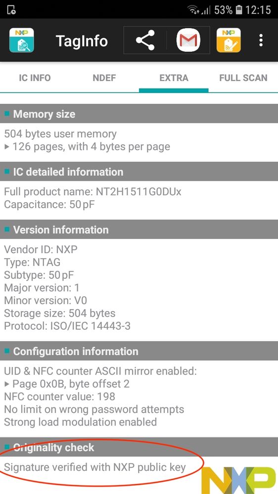

Is it possible to create iPhone application (IOS 11, NFC censor of iPhone X) that verifies NTAG-21x - I mean reads UID and signature. As I understand iPhone may only read NDEF information from tags - so it's impossible, am i right?

1) From article I see that TagInfo on iPhone only read NDEF information from tag. I not see "Signature verified" message, like in TagInfo on Android - see attached file.Screenshot_20190901-121515_TagInfo.jpg
2) From other articles on "seritag.com" site I understand that iPhone able to read only NDEF labels from NFC tags - so I can't read UID and signature. Am i right?
