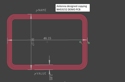

I want to have  a PCB manufactured and assembled with NHS3152 connected to antenna, as a prototype to attach my sensor.
Since i used an ECAD (EAGLE FUSION360 - Electronics) to design the chip and the antenna, I want to make sure that there aren't any obvious mistakes that can be easily caught.
ANTENNA
From Solved: Re: Open AN11276- Class_4 - Class_4.brd file with ... - NXP Community  I understood that i can  i) attach an antenna directly without a capacitor.
I designed an antenna that ii) is close to that of NHS3152DEMOBOARD (since measuring the NHS3152 DemoPCB with Reference Gerber Viewer, by the developer of the Gerber Format (ucamco.com) isn't incredibly accurate.)
Here are the dimensions of my antenna design:
In the future i can iii) change the antenna to a smaller Class4 antenna without attaching a capacitor.

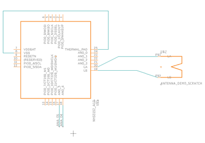

NHS3152 PACKAGE
I Designed the NHS3152 casign and footprint in Fusion360, using a QFN Package with 24 pins and a thermal pad. iv) Dimension taken from Therapy adherence resistive monitor (nxp.com)
3D package view.
CONNECTIONS

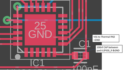

I have considered the v) Thermal pad as GND and connected VSS to it.

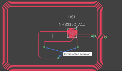

I placed vi) NHS3152 inside the antenna area, extended some wires out so that i can connect my sensor.
vi) NHS3152 Package inside the antenna area, extended some wires out so that i can connect my sensor.
--> on FR4 the demo board antenna in combination with the NHS3152 resonates at about 14.1MHz, which is fine.
If the antenna is mounted close to metal, there will be losses and the resonant frequency shifts up. This can be compensated by adding extra capacitance parallel to the antenna
If the antenna is mounted close to ferrite material, the resonance frequency shifts down. If it shifts down too much, the antenna needs less windings or a smaller size.
iii) (future) change the antenna to a smaller Class4 antenna without attaching a capacitor.
--> If the antenna inductance is lower and the resonance frequency shifts too high, you need a parallel cap to bring it down to 13.56MHz ... 14.5MHz
OK
OK

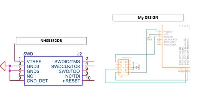

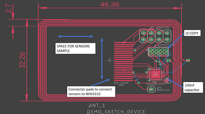

leo94
**Please let me know if its better if I upload the gerber instead of the images of the improvements i've made**
Thanks @Fabian_R , in V2 of design I've adressed your improvements please let me know if It is fit for manufacturing (or you have other suggestions) and i'll have it made rigth away:
i) Deliver energy to the chip during the 3[us] pauses in the NFC field attach 100nF capacitor from PIO pin (not 04 or 05) to VSS
I have attached 100nF capacitor from PIO0_9 to VSS.(VSS also at GND )

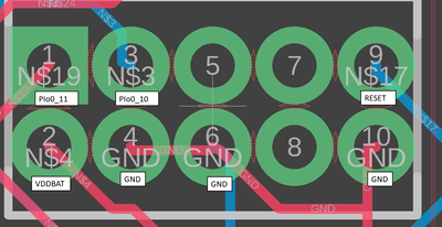

ii) Provide Testpads on VDDBAT, GND, connect to RESETN, PIO0_10 and PIO0_11 (SWD lines) and enable reprogramming via LPCLINK2 (since NFC loading is one time - like this you can reuse)
I have copied the J2 connection provided for NHS3152 Demo PCB - Like this I can conenct to LPCLINK2.
The rest are my connetions to my sensors through pins ANA0 to ANA5.

J2 connections – Copy the J2 connection of NHS3152DB – so I can connect to LPCLINK
9
RESTET
No
[10-6-4]
GND
No
1
PIO0_11
No
3
PIO0_10
No
2
VDDBAT
No
PIO0_9
VSS (GND)
No

Antenna param
ANTENNA
MODEL
NHS3152 Demo PCB
Pitch
0.6[mm]
Gap between tracks
0.3[mm]
Track width
0.3[mm]
Track thickness
0.035 [mm] (EDIT Corrected)
Nc Number of turns
5
a_0 , b_0
46.3, 32.3
PCB LAYOUT
The final design looks a bit crowded (needed space for my R&D prototype sensors sample) - here are some immages of the design:
thanks for your help,
leo
