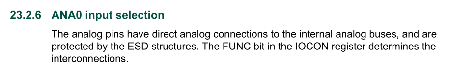

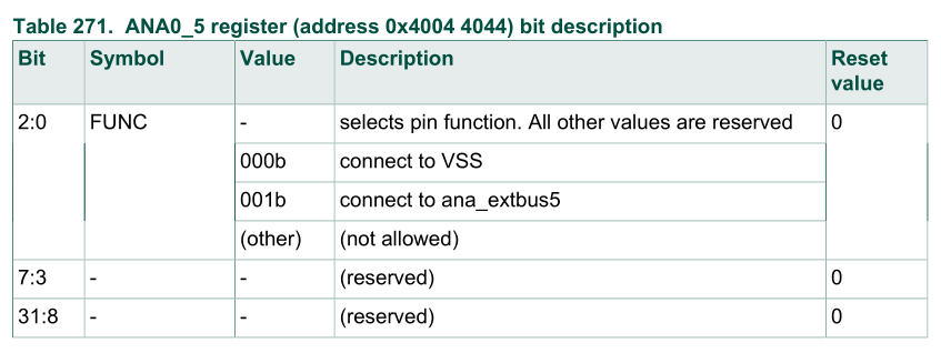

driesmoors
It seems that in the SDK example, a line mysteriously disappeared.
Can you add this line and try again?
Chip_IOCON_SetPinConfig(NSS_IOCON, IOCON_ANA0_5, IOCON_FUNC_1);
From the user manual UM10876:
and:
I'll make sure a future SDK release restores this line - truly sorry for this hickup!
Best,
Dries.

tillostermann
Hi Dries,
thank you, that resolved the problem.
Till
