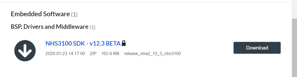

teinsu
Hi:
Download this?
7,870 Views
fangfang
Yes. Download the file from the website. Please let me know if can't download it.

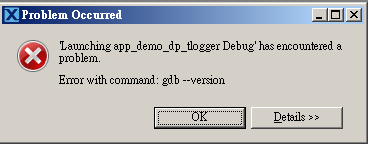

teinsu
Hi Dries:
We used the NHS3100 starter kit and tried to download the firmware, but the following error occurred, can you help check? Thank you.
7,871 Views
driesmoors
Hi Tein,
This is an error message I'm not familiar with. To me, it indicates a problem with your setup. not with the debugger board and not with the IC. Please re-check the getting started guide to see if you missed a step.
Best,
Dries.
