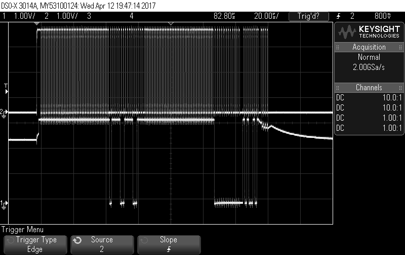

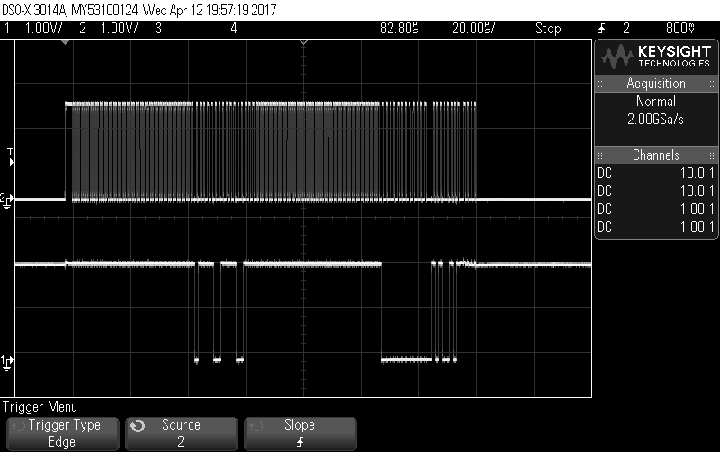

martinsmarco
Dear Support
debugging further the communications between the LPC-Link2 and the NHS3100, I'm attaching a oscilloscope picture with the SWDCLK (channel2) and SWDIO (Channel1). The NHS3100 has a CR1225 attached to its power supply (measured 3V) and its connected to the LPC-Link2 J7
If I remove the NHS3100 from the circuit I'm getting the following:
Is there any procedure to "start up" a fresh NHS3100 (paragraph 4.2.1 on NHS31xx_GettingStarted.pdf)?
