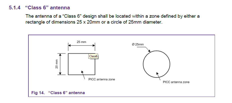

I need to use NFC in my product.
I have restrictions on antenna size of 14*25mm, can you suggest ant module or any ic with antenna?
1,693 Views
Jonathan_Iglesias
Dear Vaibhav Khandelwal,
please give me more information about  your needs, if you need a reader  what kind of  modes you will be using, R/W, card emulation, peer to peer, I assume that you need a Tag  with the size specification you mention, the smallest recommended antenna in our antenna design application notes,  the smallest antenna is the class 6 pastedImage_1.png
(click on the image to go to the application note)
this appnote is just a reference. also let me explain that NXP sell the IC used on tags we do not manufacture tags, we have a list of manufacturers https://nxp-rfid.com/rfid-ecosystem/  if what you need is a reader  we have some evaluation boards but none of them will fit your  size requirements.
