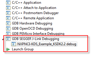

Can you use K64Fcontrol NFC?I can not flash the .bin,how do you do?
3,970 Views
Kan_Li
Hi 王明艳,
This demo supports jlink download, so you have to make sure the SDA firmware is installed correctly.
You may use the attached firmware for debug/download.
For more details, please kindly refer to OpenSDA / - SDA V2 | SEGGER - The Embedded Experts
