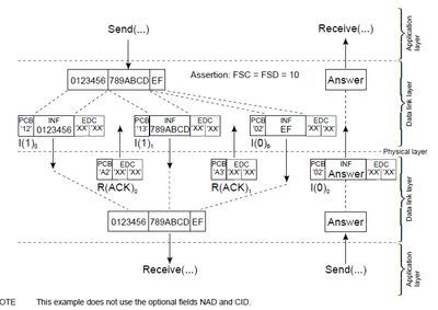

Greetings,
I have met the issue of response from APDU.
I checked the RATS's response.
However, when I send the APDU's command to mfrc630, I can't response anything.
command of APDU is as below.
APDU ={0x00, 0xA4, 0x04, 0x00, 0x07 ,_data 7byte,0x00}    // Commend[13byte]
I think about that I get the data with 0x90, 0x00 but I can't take a response.
Source code is as below.

if you use mfrc630 lib:
uint8_t mfrc630_transfer(uint8_t cmd[], uint32_t cmdSize, uint8_t data[], uint32_t* dataSize)
// all seems to be well...
uint8_t buffer_length = mfrc630_fifo_length();
//printf("mfrc630_fifo_length %d\n", buffer_length);
uint8_t rx_len = (buffer_length <= *dataSize) ? buffer_length : *dataSize;
mfrc630_read_fifo(data, rx_len);
*dataSize = rx_len;
return rx_len;
In this case before you call this function:
uint8_t res[512];
uint32_t resSize = sizeof(res);
status = mfrc630_transfer(req, reqSize, res, &resSize);
19,378 Views

RadomirT
from NXP phpalI14443p4_Sw.c:
phStatus_t phpalI14443p4_Sw_Exchange()
/* I-BLOCK TRANSMISSION LOOP */
phpalI14443p4_Sw_IsoHandling()
/* I-BLOCK RECEPTION LOOP */
19,363 Views
RadomirT
OK, data are just send to printf() for debug reason, it is just for example.
uint8_t mfrc630_14443p4_transfer(uint8_t cmd[], uint32_t cmdSize, uint8_t data[], uint32_t* dataSize)
if(status>0)
MFRC630_PRINTF("14443P4 (%lub) < ", resSize);
print_block(res, resSize);
/* NXP phpalI14443p4_Sw.c */
/* I-Block handling */
if (0u != (PHPAL_I14443P4_SW_IS_I_BLOCK(res[PHPAL_I14443P4_SW_PCB_POS])))
//OK
break;
/* R(ACK) handling */
else if ((PHPAL_I14443P4_SW_IS_R_BLOCK(res[PHPAL_I14443P4_SW_PCB_POS]) > 0U) && (PHPAL_I14443P4_SW_IS_ACK(res[PHPAL_I14443P4_SW_PCB_POS]) > 0U))
break;
res[] is internal buffer, in code is missing final data handling (memcpy res[] to data[]). According I14443P4 maybe you should check I-Block pcb and with R(ACK) block ask for consequent I-Block frames?
Never got so far in debuging.... just tested with android HCE Test tool to printf() console.
19,355 Views

AlexanderB
if you do not have access to the official ISO/IEC 14443-3 and 14443-4 standards I can recommend to have a look at ECMA-340. Which is actually quite the same.
It will explain everything you need to know about the PCB (Protocol Control Byte) handling. Googling ISO 14443-4 PCB Block Handling and other combinations also will give you plenty of results to learn about the process of it.
In case you rather read code instead of googling you can always look into the NFC Reader Library to check how it is handled there.
Greetings, Alex

minabf61
Hi all,
Just to keep the community updated, I found out what the problem was. So when sending RATS to get ATS I needed to set the FSDI to the desired frame size it was set to 16 bytes hence I was not able to recieve more than 16 bytes.
The most significant half-byte b8 to b5 is called FSDI and codes FSD. The FSD defines the maximum
size of a frame the PCD is able to receive.
FSDI"0""1""2""3""4""5""6""7""8""9-F"
FSD(bytes)16243240486496128256RFU
Many thanks for all your help. I found it out while reading the standart.
Kind regards,
Mina

AlexanderB
Hello jtpark‌,
after a RATS/ATS exchange the tag is in Layer-4 and you have to use the ISO-DEP protocol for communication. Your frame looks like a SELECT APPLICATION according to ISO-7816-4. This frame you would have to embedded into the ISO-DEP block format.
You can check following specifications:
@see NFC Forum Digital Protocol TS [16 ISO-DEP Protocol]
@see ISO/IEC 14443-4 Part 4: Transmission Protocol [7 Half-duplex block transmission protocol]
To give a short summary about it. You are missing the PCB (Protocol control byte), in case you do not use DID. For an information block (I-Block) without DID or chaining the PCB would look like 0000 001Xb, where 'X' is the block number and alternating from frame to frame (02h, 03h, 02h, 03h, ....)
For a quick test you can just set the PCB at the front of your command and you should get a response:
APDU ={0x02, 0x00, 0xA4, 0x04, 0x00, 0x07 ,_data 7byte, 0x00}
I hope this was helpful.
Edit: You can use the NXP NFC Reader Library which offers several classes to handle the ISO-DEP protocol (it comes with a couple of rules about error detection, recovery etc...), activation and other things quite handy for a proper specification compliant communication.
Or you can just use it as a guideline for your own implementation.
Alexander
