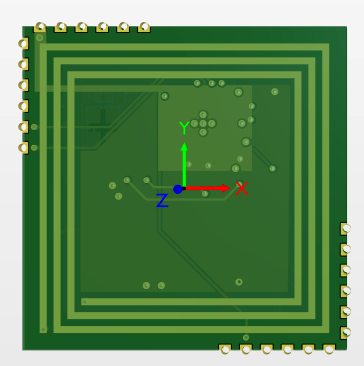

I am not any kind of expert. Just want to get design working. I have a problem with an antenna for MFRC522 NFC chip.
I used a generator for NFC antennas. So my antenna has size 25x25mm and 3 turns.

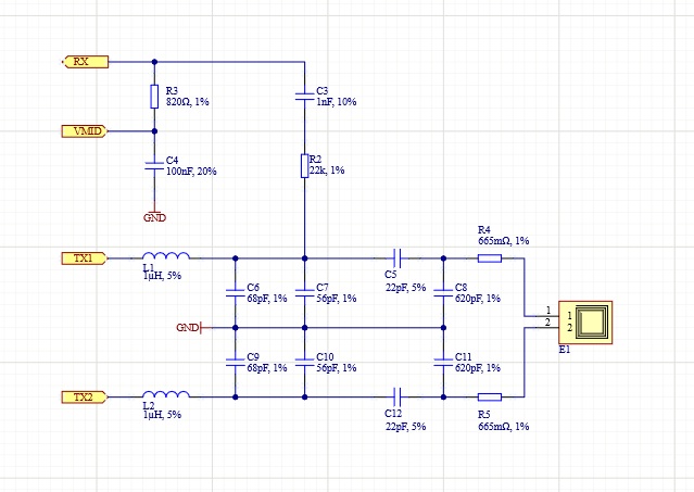

Then I used excel sheet and software provided by NXP for calculating antenna matching circuit.
Schematics:
Values were adjusted to those given by calculator

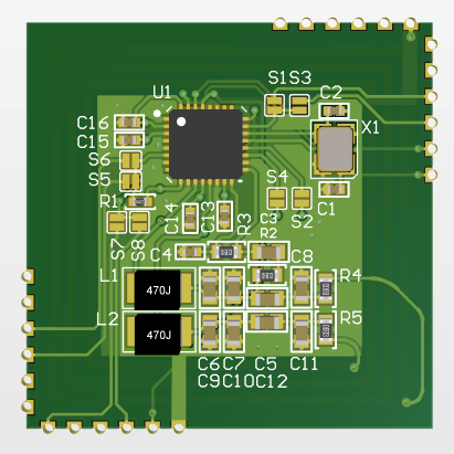

My PCB:
Right now I can’t read and write tag.
Signal from tag sniffed by oscilloscope shows some kind of communication.
I don’t have vector analyser for characterising antenna.
How to approach this problem?

stephanie_m
As the device is not recommend for new design we only have available the information and the excel calculation , still for antenna design we recommend the use of some special equipment , you can check more details in the antenna design webinars we have available in the following page .
Hope this helps.
