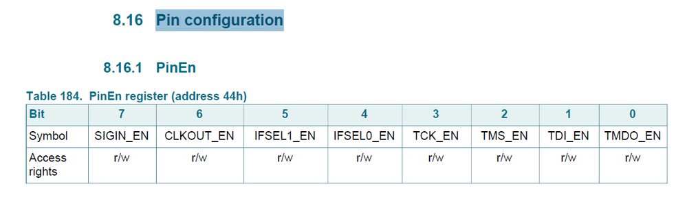

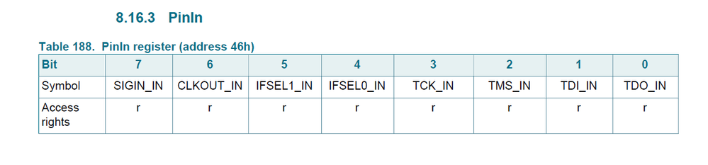

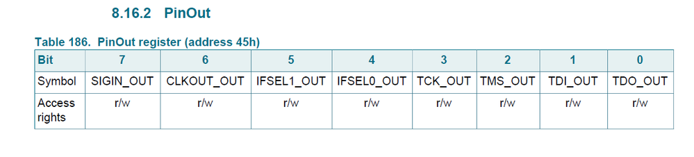

jeanbrosset
I have found in the AN11145 that unused pins are critical to found the low standby current.
independently, when i put a probe of my scope to an unused pin the standby current fall down.
In my schematics CLKOUT, SDA, SCL, SIGOUT, TCK, TDI, TDO, TMS, AUX1, AUX2, SIGIN are open.
for my next board, must i have pull-down resistors in my schematic, or can I drive by registers all theses pins to ground?
thanks a lot
Jean
4,334 Views
Kan_Li
For pins that are controlled by Pin configuration registers, you should drive them by register settings, otherwise, you may use pull-ups or pull-downs. Please refer to the following for details.pastedImage_1.png
Kan
