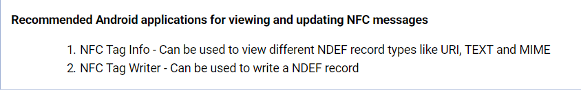

This is what is listed in the HTML documentation of SDK 11.2:
Keep in mind that the NHS3100 NTAG SmartSensor IC is using the NFC controller for communication purposes: when the phone writes to the tag, the firmware running on the ARM is responsible for reading out that data, and to generate a meaningful response. After a restart (when leaving the low power state Deep Power Down, or after leaving Power-off), the contents of the NFC memory have been cleared and reset with an NDEF message generated by the firmware application.
Also, the demo app app_example_dp_ndeft2t assumes you are using the NHS3100 demo PCB with a battery inserted. It is meant to show how a firmware developer can parse and generate NDEF records.
Best,
Dries.
